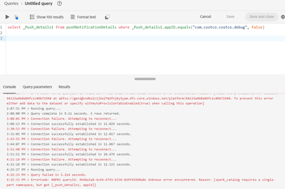

hi,
Did any one find the similar issue of qualified audience coming as zero even after the profile estimation showing some value of profiles.
While debugging the issue through query service , got to see the error attached below.
What could be the root cause of this.

Hello @ShubhankarBa1
The estimation is based off of the Sample Profile Job:
https://experienceleague.adobe.com/en/docs/experience-platform/profile/api/preview-sample-status
The data coming from these samples does not always reflect completely accurate data. Are both your schema and dataset being referenced, enabled for profile?
It also may be good to review Spark's documentation on catalog namespaces and ensuring that any integration with Adobe Experience Platform, is properly configured to meet Spark's requirements.
