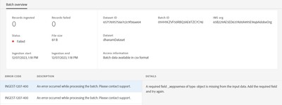

Unable to ingest data's into Event schema.
I created an Event schema, but I am facing an issues while attempting to ingest data into the schema. It's getting failed.
@Dhanam1 kindly make sure the json structure is matching the XDM schema as that is one of the common pattern we have seen which could possible cause this error.
You can download a sample file as described here https://experienceleague.adobe.com/docs/experience-platform/xdm/ui/sample.html?lang=en
@Dhanam1 If you click on the Batch ID you should be able to see some additional details on that error.
yes @Tof_Jossic ,but I couldn't identify the errors exactly.
