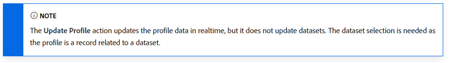

You can actually write the value of this expression using update profile activity into one of the existing attributes on profile (say age) and then use it for exports
Kindly take a note of the below - https://experienceleague.adobe.com/en/docs/journey-optimizer/using/orchestrate-journeys/about-journey-building/update-profiles
If you would like this to be handled as part of data load itself, you may want to explore data prep functionality https://experienceleague.adobe.com/en/docs/experience-platform/data-prep/home
