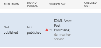

I have not received this message for any other files. The message was generated for an earlier version, and the file in question has been checked out/in several times since then without any further messages. There is a warning icon and message in the Assets list display Workflow column for the file and an entry in the Timeline that displays when the error occurred.

@Robin-M : did it occur for one/some assets uploading during a timeframe?
The logs have to be checked on the server to know why it happened - my suspect some deployment was happening at that time when the related class/code was getting refreshed on server.
However you should raise a support ticket to first get the reason before error is cleaned up.

It happened for one asset. I will open a support ticket as you suggest to see if the reason it happened is clear.
