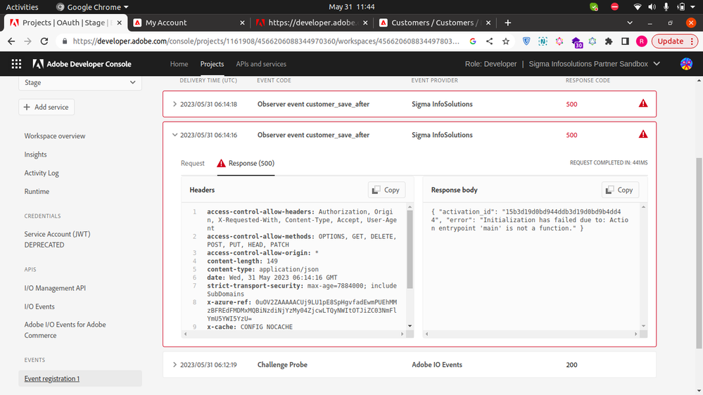

Facing issue calling soap API (created an App using App Builder)
Hi guys, i am getting below error(check in ss) while same code is worked for calling soap (as post request through wsdl function) APIs through Soap library(NodeJS) previously. I am writing my code as well, help from anyone is appreciated.
Note: i have installed soap,util library already through npm install library_name
Code:
@rohandhakad Could you try invoking the action from command line and tail the logs to get a bit more logs?
You should be able to invoke your action through `aio rt action invoke <action-name>' and get logs through 'aio rt activation logs <activation-id>'. https://developer.adobe.com/runtime/docs/guides/using/creating_actions/#invoking-web-actions
(note - you can replace "wsk" with "aio runtime" or "aio rt" in the commands)
