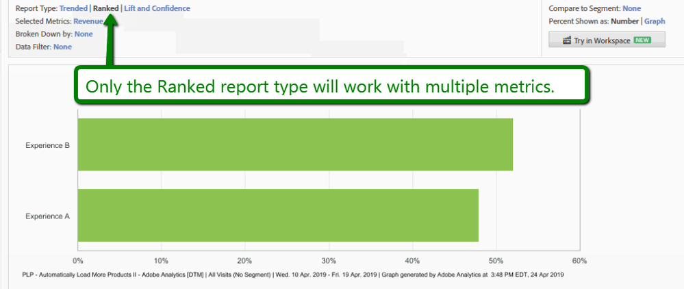

How to view multiple metrics in AA for a completed test
The only metric I am able to view in AA is revenue. All other metrics are grayed out.
jonathanc65220441​,
The report type you have selected is probably the culprit. In Analytics the Trended report will allow you to select multiple metrics at once the other two report times will force you to look at the data one metric at a time.

Here is a screen-shot of where that is located in the UI:

jonathanc65220441​,

Thanks, Mike
That resolved the issue.
