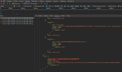

I created feeds. Simple html design which works and created criteria for last seen.
Target does not event send this activity back to the browser:
What next should I do?
In QA mode I get such an response error. Do you know this?
