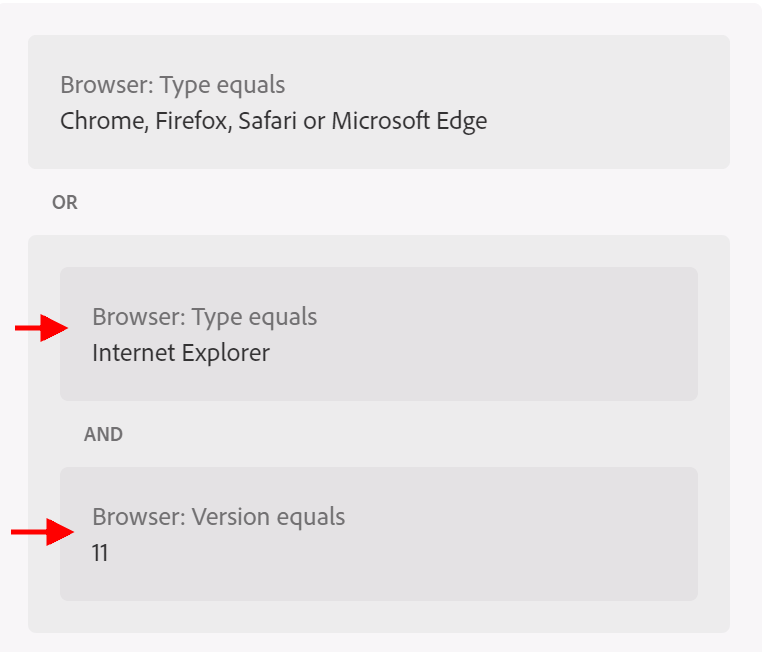

I've got an A/B test activity in which I'm targeting Chrome, FF, Safari, Edge, and IE11. All browsers work with the exception of IE11.
I can't determine what is wrong with my audience configuration. See attached.
I've included an additional OR to include Browser Type equals IE and Browser Version equals 11. Is there any reason, with this config, that I would not enter the test using IE11?

bkmills1​ I cannot see any problem with the Audience.

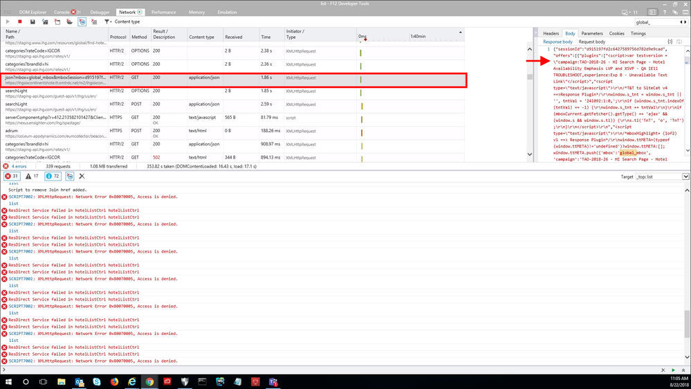

Did you check for any errors on the console window of Developer Tools?
Hi Karan,
Yes, in dev tools, the Network tab in particular, I can see a reference to the my test/experience in the Response Body. However, I'm also getting "ttMETA object does not exist" in console.
The errors I'm seeing are related to:
  • SEC7120: Origin now found in Access-Control-Allow-Origin header.
  • SCRIPT7002: XMLHttpRequest: Network Error 0x80700013, Could not complete the operation due to error 80700013.
Any idea if these could be related?

Could you also please send us the screenshot for the errors you are getting on the console?

Attached is a screen shot listing the errors I noticed this morning.
Something I didn't notice yesterday, is the global_mbox is firing, but the test is not. I should point out again that we have been able to enter via Edge. However, for purposes of troubleshooting this, I've changed the entry criteria to only include IE11.
Do you think Ensighten has something to do with blocking IE11? This is not the only test activity we're having trouble with as it relates to IE11.
