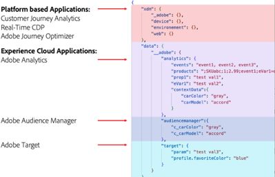

Moving a site to webSDK does not automatically prepare the data for CJA as it depends how well the schema is created. web sdk is only the transport layer, so it is your xdm schema determines how well the data works in CJA.
if site c migrates to webSDK from appmeasurement sure you
will have the upgraded better library but it is still using the adobe data object AA style (evar/prop/events fields), note that:
that data object is designed for AA/target, not CJA.
mapping props/evars directly into xdm will give you an xdm schema that looks like aa, which is not ideal for long-term CJA use.
