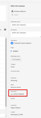

We are doing a bit of inventory and I was wondering if there is a table that we could check to see the Account ID mentioned in this documentation:
https://experienceleague.adobe.com/en/docs/experience-platform/destinations/catalog/social/facebook
The one mentioned as:
We would like to check it from query service, so we can know which destinations are using which accounts.
We have inspected the technical tables, but this field doesn't seem to be available.
Thanks in advance
