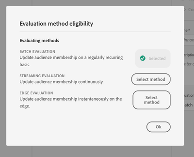

I say usecase because, you could create a segment from web events which could be edge segments but may not be really required/compatible for your destination. In this case you could change the type to batch.
Until recently you did not have an option to choose the type of evaluation but this has been recently added within the UI.  
