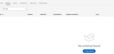

has anyone come across issues with the sandbox tooling when it comes to deploying a full sandbox package on a freshly reset sandbox?

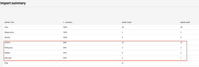

The job says success, but the details basically say nope.
On top of that, the import details just show a blank overlay.
and my custom schemas all got omitted as if something kept them from being installed properly.
however, my custom datatypes, identityNamespaces and field groups are all there.
Again, the target sandbox was just wiped 5 minutes before which the dialog even suggests.
It almost looks like things were not imported in order to make sure dependencies are met, leading to this behavior.
I mean, what makes a successful job? That everything from Adobe side is present but ignoring the 50% missing custom item? xD

However, this still did not work, and the error I was seeing was indicating that this $id rewriting did / does not work properly when you have dependencies between custom data types.
In our Example, we now have a custom data type A2 that custom data type A references
This won't work anymore in the sandbox tooling, which looks like a bug or missing feature to me.
