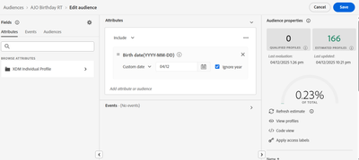

I made this audience and choose batch method as evaluation as shown in snapshot below.
But this profile is not qualify for audience after 24hr .

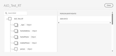

Dataset preview:

Ok got it - the value for birthDate is in YYYY-MM-DD format but I see you're excluding the year value in your segment and the value is in MM/DD format. I'm wondering if using custom date in that format is causing any type of issue.

Hello @AEP_guy / @DavidRoss91
When dates are used we need to ensure the data is ingested in the correct format of the field which is collecting data.
Based upon the screenshots it does appear the segmentation selection is correct to select data from the attribute person.birthDate.
