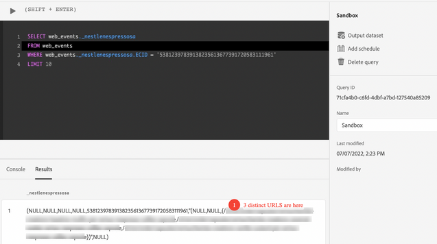

My approach is to detect distinct product pages browsed by the visitor, and provide them toward the XDM Experience Event based schema inside a property (string array type based) created for this purpose:

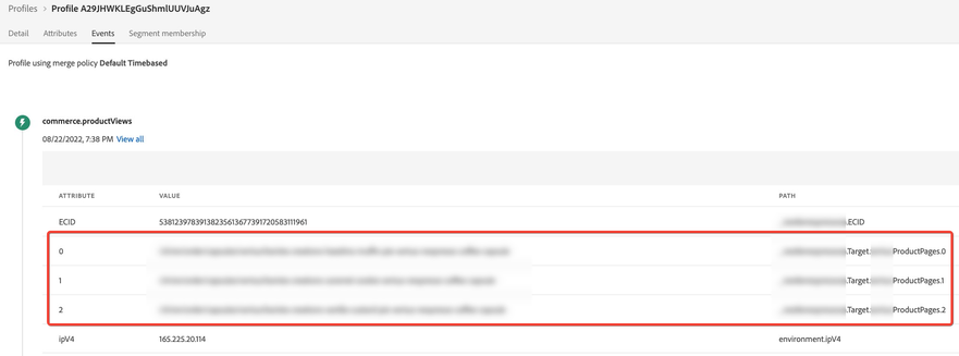

This array is filled with an alloy("sendEvent") call from a script included inside the <head> section by Target.
Checking some profile confirm the array is filled with up to three product page URL successfully:

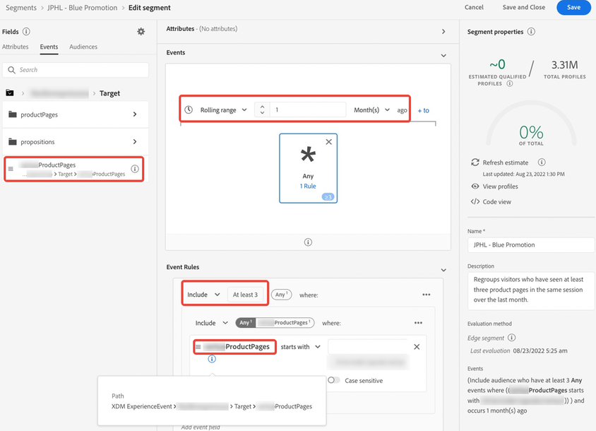

Then I would like to create a realtime segmentation which detects when the XDM Event schema string array contains at least 3 entities in realtime. The idea being to reuse this segmentation on Adobe Target side as an audience to trigger the banner display.
However, on AEP, I cannot find any matching profile nor I can save my Edge based segment. Is this the right approach or am I missing something here?

Hi @jean-philippe_8 ,
The logic sounds fine. One thing you could check is the time range you have provided. If you wanted to check for within the last 30 days you might want to change time frame condition to something like below:
The time frame you selected might be checking for beyond one month. Depending on your implementation state it might not qualify any users to the segment.
Let us know if changing the time rule works for you.

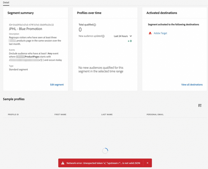

But even if I restrict the date range to 24 hours with or without the aggregation my profile (updated today and confirmed with the profile preview inside AEP) does not pop out...
Even simplifying the segment reveal another strange error code upon Profile preview:
Could it be related with how the property has been defined inside the XDM schema ? ( type = String[] ) ... ?!?
I was able to get it to work:
  1. Check your Merge Profile is Edge Enabled
  2. Make sure you are counting on the Array, not the Event.  You are counting on the Event.
    1. Drag the array in and then change to Agg.
    2. Then drag in the "where" field in the same container
Gorgerous! Thank you for your tenacity. By doing so the segment is still an Edge one and it can be saved.

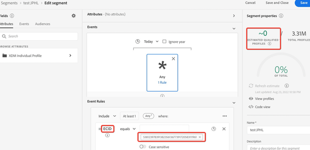

However, the segment is still empty 😕 So I counter validated by creating another segment based on the Event related ECID matching both the alloy("getIdentity") feedback in the browser as well as the one being displayed in AEP in the profile section
... still an empty audience.
I must be missing something here but can not find out what ?!?
I event requested the profile event directly from AEP and found it so I don't see why the segment is still empty, even if I provide the correct ECID ???
