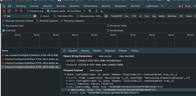

Hi @Franc_G
this is a working sample URL from one of my clients.
https://www.someclient.ch/de/index.html?adobe_mc=TS%3D1720162921%7CMCMID%3D4529836067192262621031948...

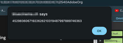

on the receiving end, if I execute the alloy getIdentity call
alloy("getIdentity")
  .then(function(result) {
      if (result?.identity?.ECID) alert(result.identity.ECID);
  .catch(function(error) {
    console.error("something went wrong", error)
Note that we're using a different use case, we're using the Web SDK "Redirect with identity" action to append the identifiers on link clicks between known domains.
But the basic logic behind it is the same, hence the identityMap is also populated with the ECID.
