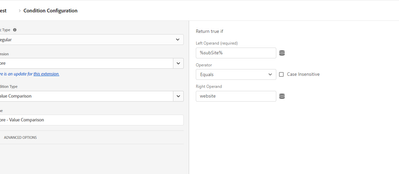

So in your example if you have domain/website1 and domain/website2, you can then use this DE to check like this:
if (_satellite.getVar("subSite") === "website1") {
// Do the code for website 1
}Or you can use Rule Conditions to go:
