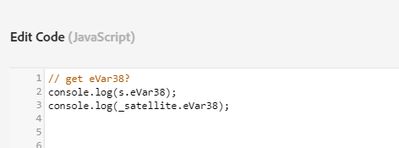

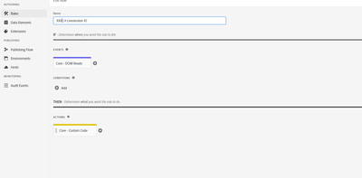

I’m trying to get an eVar in a custom code box using JavaScript so I can pass it to another system. Documentation says it should be s.eVar. But of course that is returning "undefined" for me. My question is how can I get that variable?
The  Rule

There are a 2 issues. (one right now, one I bet you'll discover later)
1) eVar38 is on the "s" variable. When editing custom code - The variable with the analytics attributes is "s". [But if you look in the browser during debugging, the minifier may change the variable to probably by "t".]
This means you want s.eVar38 ... or console.log("s.eVar38=" + s.eVar38)
