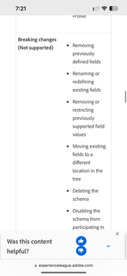

How to change the data type of an attribute where schema is enabled for profile and also have a dataset ? which we cannot delete

Hey @BellaSnow5378
You would not be able to change the data type of an existing field in a schema enabled for profile and as you mentioned already has a dataset attached to it.
It is a breaking change and would not be allowed.
You can read more here: https://experienceleague.adobe.com/docs/experience-platform/xdm/schema/composition.html?lang=en
Cheers,
Abhinav
Yeah, this is one of the things that I don't like about schemas that are Profile-enabled. I understand and appreciate the limitation, but the restriction is really irritating.
Let this serve as a reminder to have very detailed names for your fields/field groups, so that you can create new ones that have new meanings/contexts as-and-when required.
Just expanding upon this response. Creating a new field with the desired data type along with a full data load would be the way to go.
This is a breaking change and not allowed for Schema that has data and profile enabled.
