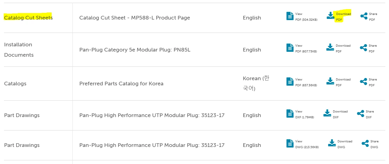

On our websites product pages, visitors have the ability to view, download or share various types of resources/reading material.  Resource Types include Catalogs, Installation Documents, Part Drawings, etc.  What I'm trying to do is capture the Resource Typed that is clicked after a visitor clicks view, download or share.  (examples below)
I created a data element to capture the value for the resource type
I also created a rule which is structured as:  IF a visitor clicks on one of the three resource options (view, download, share).  THEN set an eVar to capture the text of the resource type.
When I went to check this rule, I noticed that the data element being recorded was always the first resource type listed on that page.  So in the below example, "Catalog Cut Sheets" are listed first, but if I clicked on download a Catalog, the data element would see that as a Catalog Cut Sheet.
I'm sure there's a way to capture the correct value based on how far down the page a visitor clicks; however I'm not familiar enough with page code/CSS Selectors to find this on my own.
So my question... is there a way to record the resource type clicked on so that I don't keep capturing the first product listed on each product page?

| Resource Type |        | File Name |                  | View - Download - Share |
