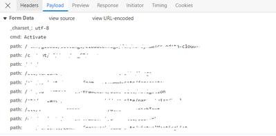

I can tell what happens when you click on 'Quick Publish'
1. Servlet "/bin/replicate" gets invoked.
2. It has list of all the selected pages in 'payload'. cmd tells if it is activate or deactivate action.
Hope this helps to get you started with your problem.

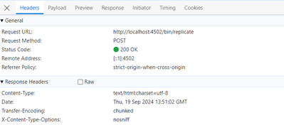

i need to know how these paths are sent to /bin/replicate. are they using eventListener API of java to catch published content? In network tab request is made to /bin/replicate.
selected paths for replication are obtained in javascript flle of quickpublish button through Granite API.
