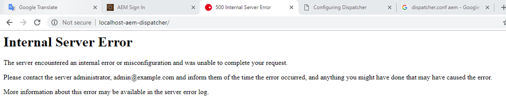

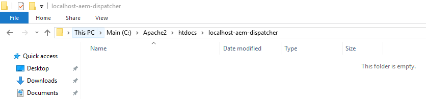

Now, I have configured dispatcher in aem in order to work cache in dispatcher.
But when I go to http://localhost-aem-dispatcher, Internal Server Error happens and the folder(C:\Apache2\htdocs\localhost-aem-dispatcher) for caching is empty like that.
Can you help me fix the error? I have no idea why.

I fixed Internal Server Error.
I changed my VirtualHost setting like that.
C:\Apache2\conf\extra\httpd-vhosts.conf
NameVirtualHost localhost-aem-dispatcher:80
<VirtualHost localhost-aem-dispatcher:80>
ServerName localhost-aem-dispatcher
ServerAlias localhost-aem-dispatcher
DocumentRoot C:/Apache2/htdocs/localhost-aem-dispatcher
ErrorLog C:/Apache2/logs/localhost-aem-dispatcher-error.log
CustomLog C:/Apache2/logs/localhost-aem-dispatcher-access_log common
<Directory C:/Apache2/htdocs/localhost-aem-dispatcher/>
<IfModule disp_apache2.c>
SetHandler dispatcher-handler
ModMimeUsePathInfo On
</IfModule>
Options FollowSymLinks
AllowOverride None
# Apache httpd 2.2
Order allow,deny
Allow from all
# Apache httpd 2.4
# Require all granted
</Directory>
</VirtualHost>
But I have still the problem that caching in dispatcher doesn't work.
Can you help me work the caching in dispatccher?

I think Require all granted supports in Apache 2.4 version only.
I think Require all granted don't support in Apache 2.2 version.
My Apache version is 2.2.
You need to use below one
Allow from all
I already used below one..
Allow from all
but caching in dispatcher doesn't work.
what should I add in /cache in dispatcher.any ?
I found the following informations below url.
"You cannot add the Require all granted
line in Apache 2.2, or you’ll get a 500 Internal Server Error."
