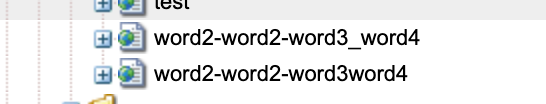

I created experience fragments using naming pattern "word2-word2-word3_word4", but the node name that is getting saved in the CRX is:  "word2-word2-word3word4". Underscore is getting ripped off of it comes after in the naming. But these work: "word1_word2", "word1-word2", "word1_word2-word3".
I noticed that after 19 letters in the naming, the underscore gets replaced by empty string.
Is this a product bug?

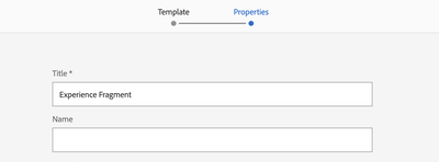

If you use as it is in a Title field  then it will remove the space(and invalid characters), this OOTB behaviour.
If you need to set node name with _ then put in the Name field.
Examples:
