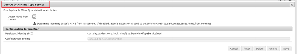

    • Can cross verify the asset "Properties" from being in DAM. In particular, "Type" property
  • Look for OSGI configuration related to MIME type in both local and PROD. There exist a config named "Day CQ DAM Mime Type Service" in 6.5.0. Not sure of its equivalent from 6.1 (Should be available in the same name. Else, do search for MIME type and locate the one related to DAM)
