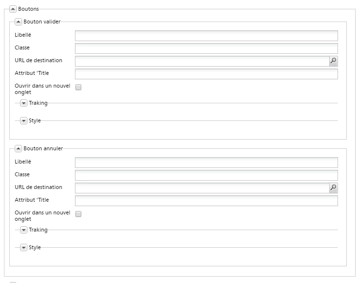

I'm trying to create a dialog which have repetitive fields. As shown in the picture below, we sometimes need to reuse a set of fields (to avoid having a very long file, and also to update those fields only once when needed). Its easy to do in classic UI by defining all the fields we want to reuse in a separate file and then including them everywhere we need with include and a namespace. This method provides us a child node with all the properties for a button for each instance.
Here is an example of the classic code (the dialog using the template xml) :

This is what it looks like in classic UI
All the fields are the same for Validate and Cancel. We use the template as it is. And we can have more than 2 buttons on the same component

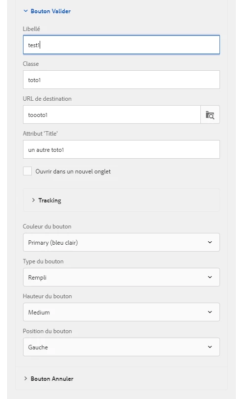

So far I've not been able to do this in Touch UI. I'm able to include the template using this :
<buttonjcr:primaryType="nt:unstructured"
   sling:resourceType="granite/ui/components/foundation/include"
   path="/apps/EDF_RC/components/defaults/boutonV3TouchUi/cq:dialog/content/items/column/items/boutonV3Touch"/>
The problem is that I can't define a namespace so it would create a child node. It puts all the imported field on the main node, which leads to all of them being overwritten. In clear, instead of doing mainNode.stepCValidateButton.textBtn to access the validation button textBtn attribute like in classic I have to do mainNode.textBtn and this leads to textBtn getting overwrote when I edit the cancel Button textBtn attribute. I hope all this is clear for you. We are using aem 6.4
