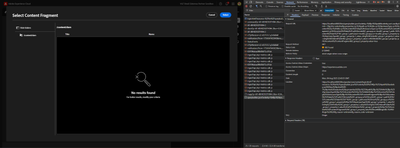

Still able to add, remove and edit the members and every property of the teams component. But for selecting a CF from the modal I have no options to DAM folders and the same 302 issue in the network console to the following endpoint:

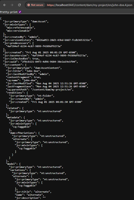

When acessing any of those endpoints directly from the browser I get correct JSON in response.
Also, I have successfully fetch 8443 data from the frontend openned in UE. Seems the local instance is redirecting UE to the void. Is it a missing configuration? Any clue to solution?
