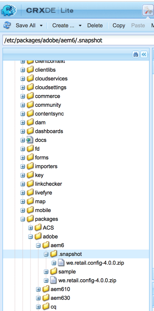

Immediately prior to installation of your package, a snapshot package(under /etc/packages/<package_group>) is created to contain the content that will be overwritten.
This snapshot will be re-installed if/when you uninstall your package.
You cannot uninstall a package if the ".snapshot" directory is not there.
