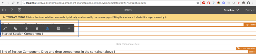

We are using editable templates, after adding the components to the editable template I noticed that there is no trash icon in the toolbar so we are unable to remove the component from Template. Is it expected behavior with the editable templates because when I use the same component on static templates I am seeing trash icon and I am able to remove the component.
Note:
We are not seeing trash icon for the components in their rendering script
If we referencing content within structure components via data-sly-resource using the @ resourceType option, we are unable to delete the component.

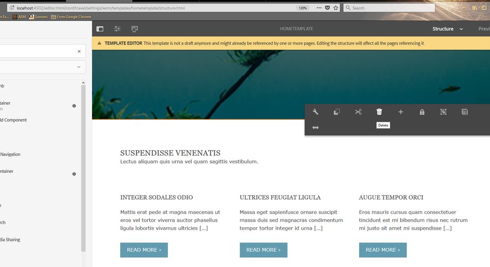

If we do not have any referencing content within structure components via data-sly-resource using the @ resourceType option we are seeing the trash icon like shown below.

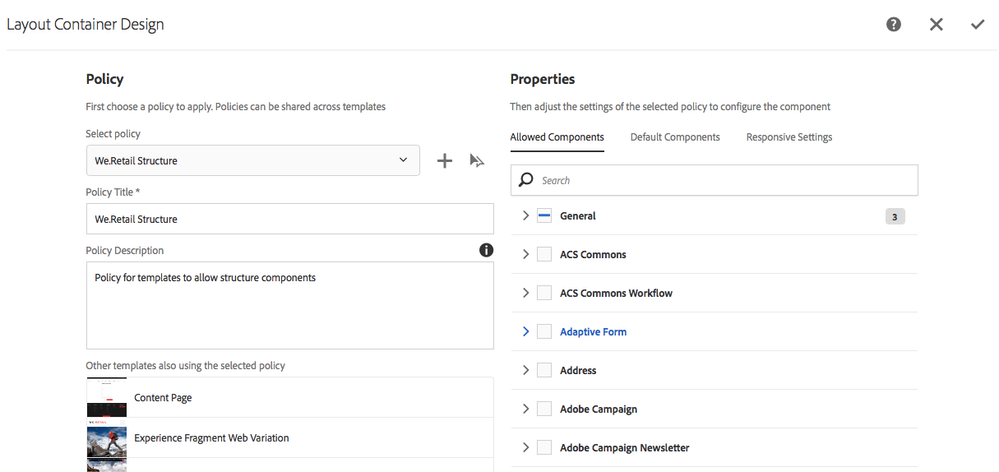

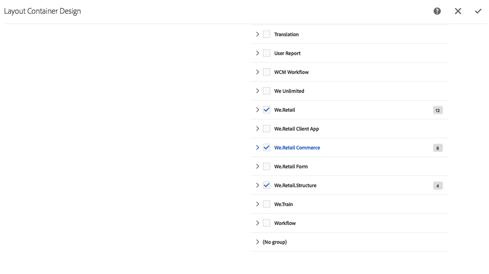

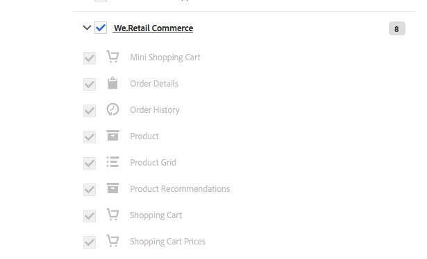

You need to remove those components from allowed component property of template.
Example:

Yes, I did try to do like that but once we add the components (in my case section) to editable templates they are not disappearing even if you unlock the component from template and go back to the policies and try to remove the components.
I found one article about it, after following those steps (after adding the section component and if I authored it I am able to see the trash icon/ delete button) I am able to remove that component from editable template.

If the component is locked in the editable template - only way to delete it is from the template view. You cannot delete (or even modify) a locked component from the page view. A locked component results in an author not being able to touch it within the page view (see the video below).

I had the same problem. The Stackoverflow solution indeed helped. https://stackoverflow.com/questions/50447249/not-able-to-remove-components-in-editable-template-aem
For me, I had to go into the editable template and switch from Structure to Initial Content, in order to add content to the component. Then I was able to delete it.
