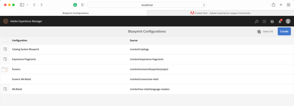

While creating a blueprint, as soon as I click on "create",
I see this error page,
 help me out here please.
