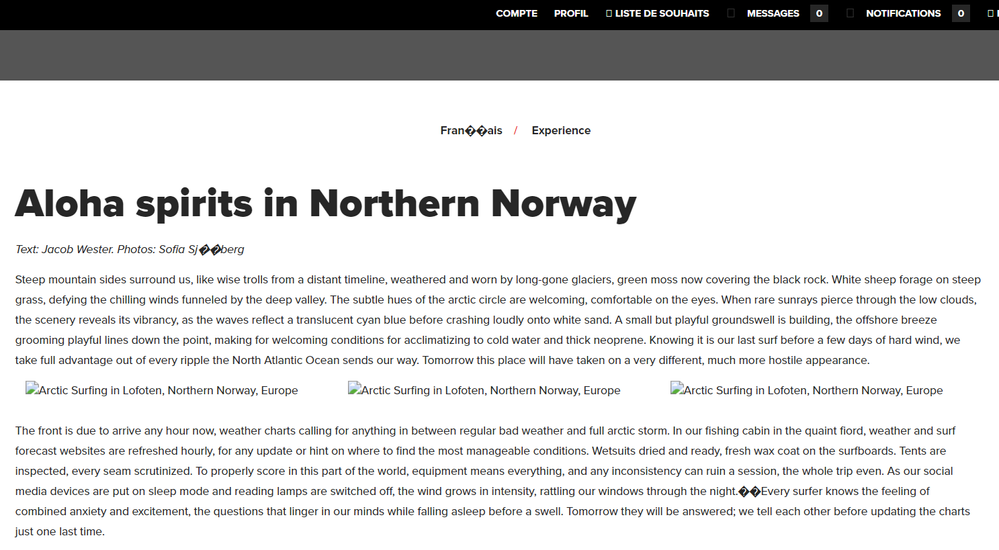

I am trying to use the TranslationObject#getTranslationObjectPreview method to get a preview of a page.
I expect a zip with all files required to open the page offline, independently of AEM.
I would then like to send this archive over http to a server (which I believe is only tangentially important).
My issue is that when I open this zip package, the html page has broken encoding and image links:
Exploring the archive structure a bit I find the images from the body of the article, however, the html does not link to them correctly. I could not find images for the icons or the image from the top of the page.
My question is, am I doing something wrong or is this the full extent of the preview feature that AEM supports?

HI @janhumpal
We had a similar requirment to create page preview zip. We faced similar issues with zip created from getTranslationObjectPreview so we ended up creating our own utility to create page preview zip.

Thank you for your feedback! I was afraid it might be the case, that circumventing the translation framework here will be necessary.
