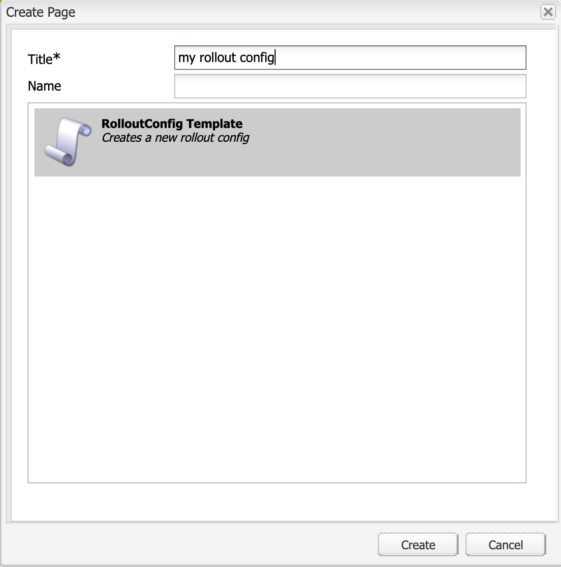

3-go to http://localhost:4502/miscadmin#/etc/msm/rolloutconfigs and reate a rollout configurations: edit > new Page >
4- go back to http://localhost:4502/crx/de/index.jsp#/etc/msm/rolloutconfigs and add your cq:LiveSyncAction under jcr:content
example:
fore: /etc/msm/rolloutconfigs/my-rollout-config copy a cq:LiveSyncAction to
/etc/msm/rolloutconfigs/my-rollout-config/jcr:content
5- copy the rollout configuration you juste created to /apps/msm/wcm/rolloutconfigs
you should be able to see your custom rollout configuration after this.
