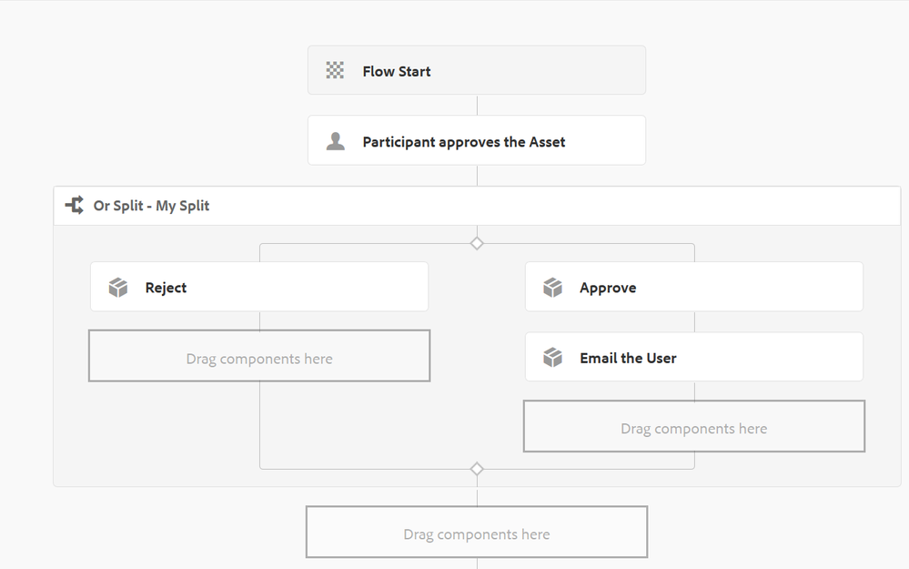

I would start looking at workflows - they are exactly what you need. You can add much better logic, send emails, setup approval use cases ,etc. See this article that shows how to setup a basic approval workflow that sends an asset through as a payload.
Scott's Digital Community: Invoking an Adobe Experience Manager Custom 6.4 Workflow from a web page
A typical approval workflow looks like this:
Then you can build your workflow out to meet your business requirements - publish pages, etc.

A few things - when you put your page through a review cycle - are you using workflows? (Sounds like you are not from the previous comment).  Using AEM Workflow to approve content is typically best practice in AEM. You can then use an OR split and define workflow logic to handle when a page is approved or not approved.
