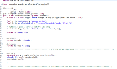

Sure, I'm providing the screenshot of my sample code.
Here is my configuration class:

@lukasz-m @arunpatidar Can you please help me, I have attached the screenshot of my sample code in Below comments.

The thing is when i place my logic of void run, under void run() of your of code which you have provided. The scheduler disappear in Sling scheduler console.
Hi @avi_infy,
The problem is that line:
@Reference
private Resource resource;
Your OSGi component most likely did not start is not satisfied, because it was not possible to get above reference. You can confirm component status under /system/console/components.
Unfortunately you can not get resource in above way. You will need ResourceResolver and path to resource. You can get ResourceResolver via ResourceResolverFactory.
Please remove above line from you code - this will allow you to confirm that this is a root cause.
