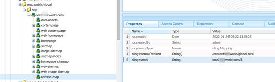

We are using AEM 6.5.14. The map and reverse map is properly configured. From /system/console/jcrresolver the resolve and map is working fine.
But from code we can not get the full path from domain. In short request.getResourceResolver().resolve("http://local.---world.com").getPath() is not returning the full path.
THE MAP
FROM  /system/console/jcrresolver

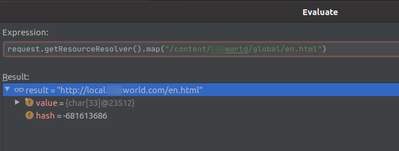

FROM code map is working
BUT from code resolve is not working

  1. Created the reverse map node on /etc/map
  2. Searching manually under /etc/map when needed with the domaain
  3. Then concatinating with path.

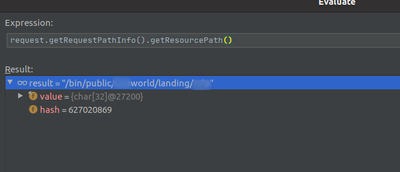

If you have access to the slingRequest object, then you could use it to get the resource path, something like this:-
request.getRequestPathInfo().getResourcePath()
In this case it will return the servlet path not the content path, because the request is coming on a servlet. And the code snippet you gave returns the current request path info. In my case its a servlet.

Can you try resourceResolver.map(...) instead of resolve.
map is to convert long path to short path.
i.e : contentPath=/content/---world/global/en.
now if i use resourceResolver.map(contentPath) then it will retuen http://local.---world.com/en.
I need the reverse one. I need  this from http://local.---world.com  -to>  content/---world/global.
