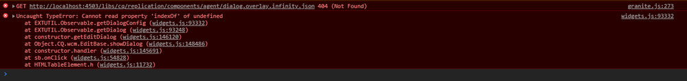

Hello, AEM Community
I have the following issue: when I click on "edit" in any replication agent on publish instances (on author works fine), the configurable dialog doesn't appear and there is the message in the console:
But dialog is situated under this path.
AEM 6.3.

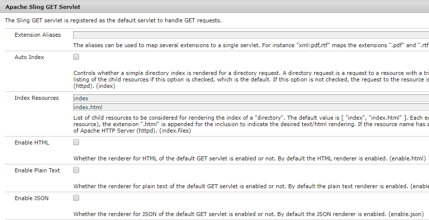

It turned out that Apache Sling Get Servlet is having in configuration "Enable JSON" = false:
Due to this there were 404 requests to request with extensions .json.
Thanks all of you for such active discussions.

Unfortunately, there aren't some messages about errors dedicated to replication in error.log. There is just a message in access.log:
10.0.2.2 - admin 03/Oct/2019:13:51:42 +0000 "GET /libs/cq/replication/components/agent/dialog.overlay.infinity.json HTTP/1.1" 404 363 "http://localhost:4503/etc/replication/agents.author/publish.html" "Mozilla/5.0 (Windows NT 10.0; Win64; x64) AppleWebKit/537.36 (KHTML, like Gecko) Chrome/77.0.3865.90 Safari/537.36"
Yesterday, I faced with the following message:
02.10.2019 10:23:57.471 *ERROR* [qtp1328305755-26924] com.day.crx.delite.impl.servlets.FilesearchServlet Unable to search
javax.jcr.query.InvalidQueryException: java.text.ParseException: Query:
//.libscq(*)/replication/components/agent; expected: <end>

But today there is no logs about it and configuration doesn't work all the same.
Sorry, what do you mean "bypass dispatcher and directly go to AEM instance"?

正解者
Hi all of you!
Please do not open the JSON representation of the default get servlet on publish, because then every URL can be fetched with the .json extension and might be handled by the DefaultGetServlet. And if not properly secured, the .2.json might work as well.
Jörg
Hi, Jörg Hoh
Thanks for your answer. Well, this is a very good question we are thinking about right now. Could you please give an advice:
-Should "enabling JSON"=true be on publish instance? If yes, is it enough to restrict ".json"-requests to security paths in config dispatcher?
Or do you think that it is bad practice to enable json representation on publish instances?
Thanks, Artur.
In my opinion you should disable it whenever possible on publish. That prevents quite a few angles to extract information from publish instances, often without any negative impact on functionality. There should not be a need to use to configure the replication agents on publish, and the rare occassions you have to you can also use the crxde light to change it directly there.
Jörg
Thanks a lot for your consultation! I agree with you.
