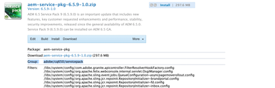

    • For eg. I have service pack 6.5.9 uploaded yet (not installed).
    • The group is adobe/cq650/servicepack
  3. When the package is in uploaded state you cansee a n
    ode in crx at:/etc/packages/adobe/cq650/servicepack
  4. Now, when you install the package, a .snapshot folder is created which has info about the installation:
  5. To achieve your use case of deletion of package to reclaim space, you can delete the node safely and your package content remains installed and intact.
