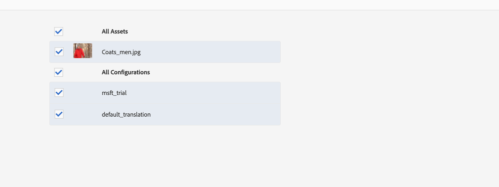

I am facing issue to view the references of the page 'localhost:4502/sites.html/content'. I have edited the components in a page and author some unpublished images. Now when i try to publish page from the left corner menu option, i can see the references listed that needs to be published. Screenshot 2019-05-20 at 6.31.37 PM.png

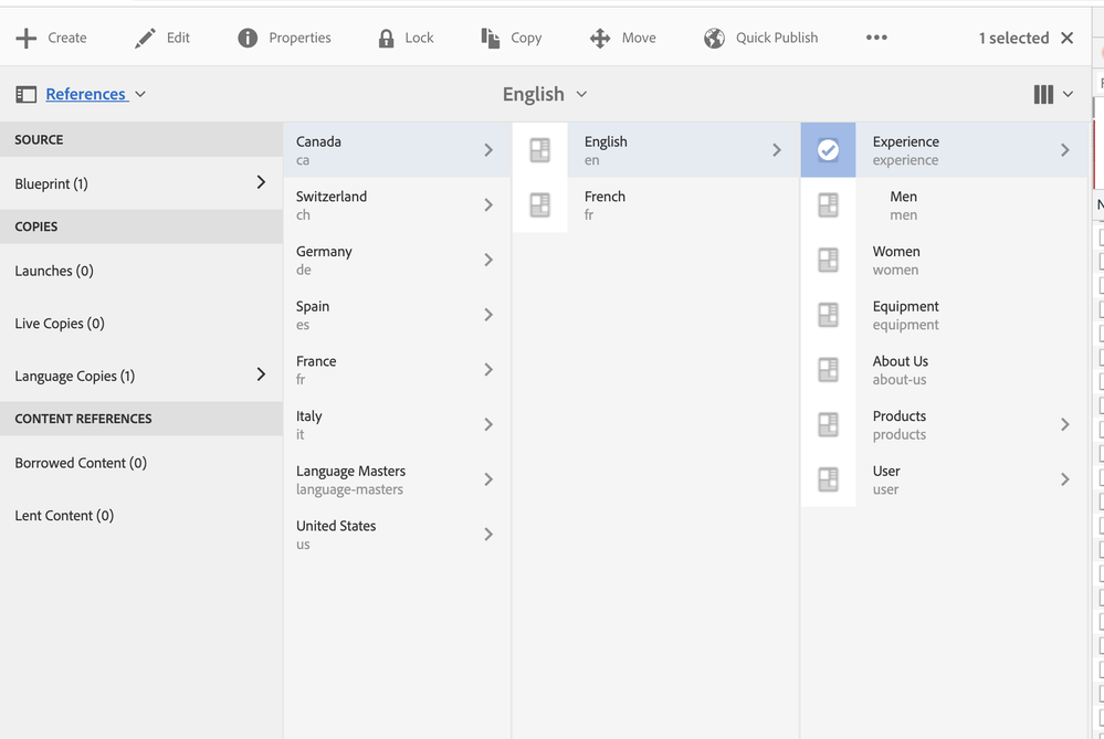

But when i select my page and  try to see the references of that page in references dropdown present in sites.html. Then it shows nothing except 0 value for every it tried authoring.
Can you let me know how to get the references?

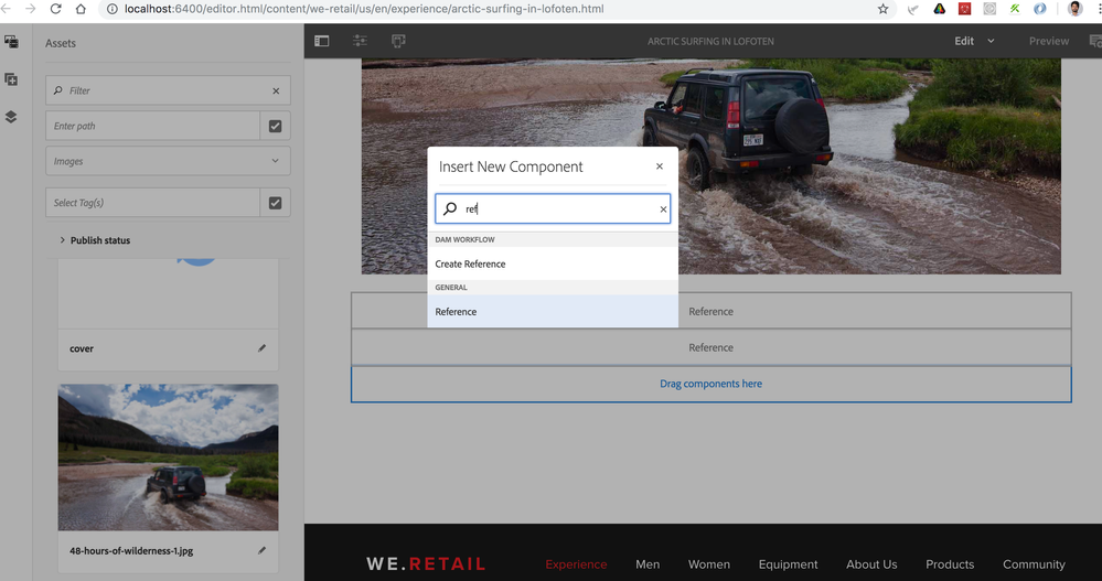

I believe you need to use the Reference Component under the General Category in order for references to show up in the left pane.
I tested this on my local instance and using the reference component works as expected.

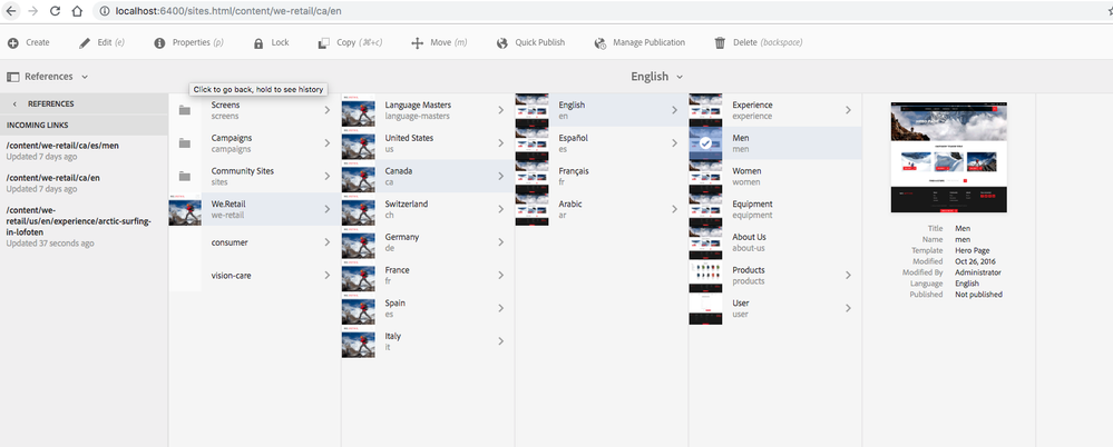

Yes, the reference rail will show the links you reference within the components. The example below from my local instance :
- Opened a page named "/content/we-retail/us/en/experience/arctic-surfing-in-lofoten.html"
- Added an RTE component to the page and then a link to "/content/we-retail/ca/en/men.html" within the component.
- Go to references for "/content/we-retail/ca/en/men.html" and notice that incoming links will have the reference for "/content/we-retail/us/en/experience/arctic-surfing-in-lofoten.html"
