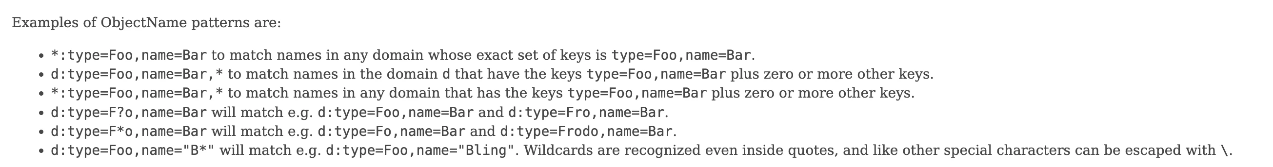

Hi, Esteban, thanks for the direction. it is working now. but i have another problem. For the JMX cold sync Mbean, it has multiple instances. how do i get all the instances? for example if you go the JMX page and search by "standby", you will get multiple instances shown in the picture. how do i get the multiple instances? when i do
ObjectName objectName = new ObjectName("org.apache.jackrabbit.oak:id=\"Client c31f948f-5ec9-4bf4-9fb5-5b259018aa93\",type=\"Standby\",name=Status"); i get the instance with given client ID. but if there are multiple instances with corresponding multiple clients, how do i get all the instances?

You just need to find a pattern that gives you all the instances you need while creating the `ObjectName`. In the code you posted, you are being too specific to get this item: "org.apache.jackrabbit.oak:id=\"Client c31f948f-5ec9-4bf4-9fb5-5b259018aa93\",type=\"Standby\",name=Status".
Please check this as a reference: https://docs.oracle.com/javase/8/docs/api/javax/management/ObjectName.html
hi Esteban, thanks for the direction and yes it worked. but with a slight change. so, if anyone want to get multiple instances of JMX beans, you need to give a pattern and all the instances that satisfy that pattern are returned. the objects are returned in a set.
MBeanServer mBeanServer = ManagementFactory.getPlatformMBeanServer();
Set<ObjectName> allInstancesSatisfyingThePattern = mBeanServer.queryNames(new ObjectName("org.apache.jackrabbit.oak:type=\"Standby\",name=Status,*"), null);
