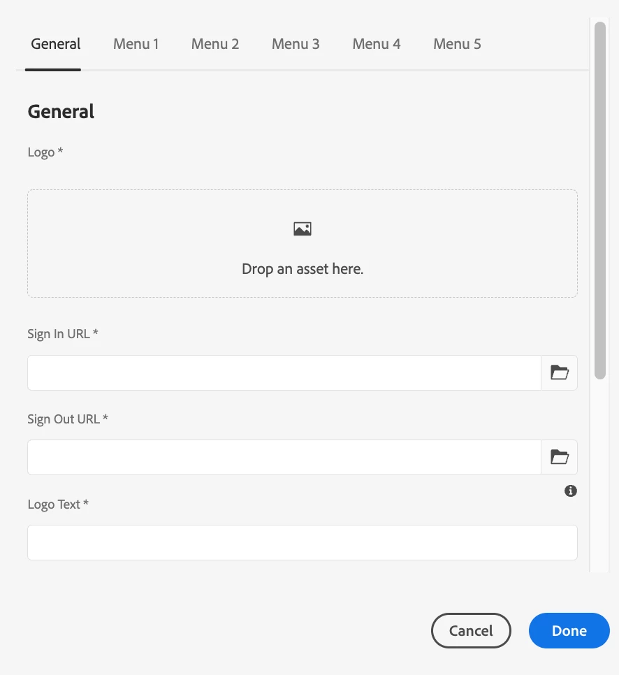

A few questions while building an AEM custom functional test:
To build a test for a custom component, such as the one below, what kind of arguments are needed. What should be the format of the argument?
Are there any demos available to use as a reference?
