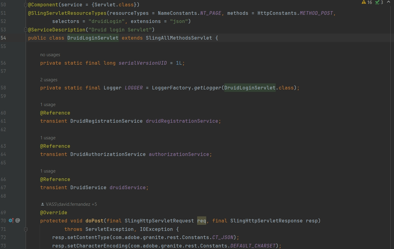

So in our case, we call an internal sevlet, from which we then call the api, will attach some snippets as a visual example.
When the api receives our request in that case, is the sender the domain from which we called the servlet initially www.example.com or is it the domain of our specific adobe servlet.

Hi @danielma63,
Based on your code and description, here is what I understood:
  • You have an internal servlet (DruidLoginServlet) hosted within AEMaaCS.
  • That servlet makes an outbound call to an external API using a method like callApiDruidGet(...) via HttpClient.
  • The frontend (eg. www.example.com) makes a request to your servlet.
  • That servlet then calls the external API.
When your AEM servlet (on AEMaaCS) sends a request to the API from the backend, the origin of the request (from the API’s point of view) is AEMaaCS's server infrastructure, not the original browser/client (ie. not www.example.com).
