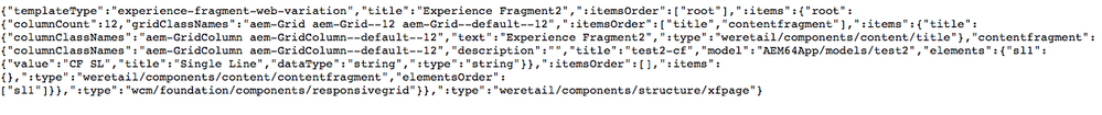

arunp99088702​ I have one more question here, so content fragment is kind of an asset and we can use   /api/assets/samplefragment.json to expose the json, do we any APIs that can expose the same for EF ?  And the api/assets actually helps download the content fragment also. Do we have anything similar to that for EF ? My requirement is more like storing the EF as an asset.
Hi you can model selector with json extension to expose XF as json.
It'll show output like below for http://localhost:4502/content/experience-fragments/aem64app/experience-fragment2/master.model.json

http://localhost:4502/content/experience-fragments.infinity.json  This will serve the same purpose, won't it ? Anyways I will try out the Model selector as well, but do you have any idea how do I store the EF as an asset because the implementation is of cq:page for EF ?
Yeah, It is more or less similar to infinity selector but not the same , if you are planning to expose content as a service, better to you model selector.
you can't save experience fragments(XF) as a assets but you can use XF inside any page like CF.
