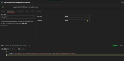

  • When I visit http://localhost:4502/libs/granite/csrf/token.json, I can see the value of token.json
  • I tried the same thing using postman (the only extra thing I did in postman is to pass admin/admin in basic auth) and I don't get the same issue.

Hi jayv25585659
I tried access  http://localhost:4502/libs/granite/csrf/token.json using postman. It works for me.
