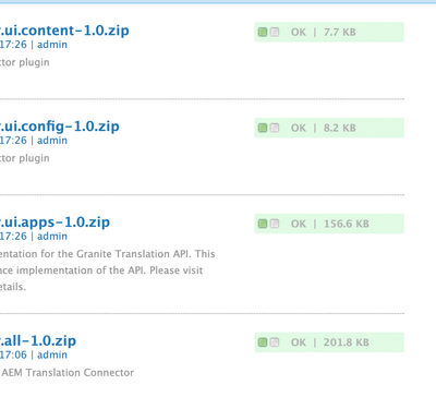

UPDATE: when I refresh the Package Manager page, the packages status switch to ok or to install at each refresh. This doesn't happen with autoInstallPackage because all packages are installed individually
