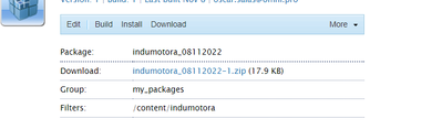

I am facing troubles with the site theme.
This is the package I'm building.
@olsalas711 Site theme would be part of your code package. Have you deployed the code package as well to your local instance?
