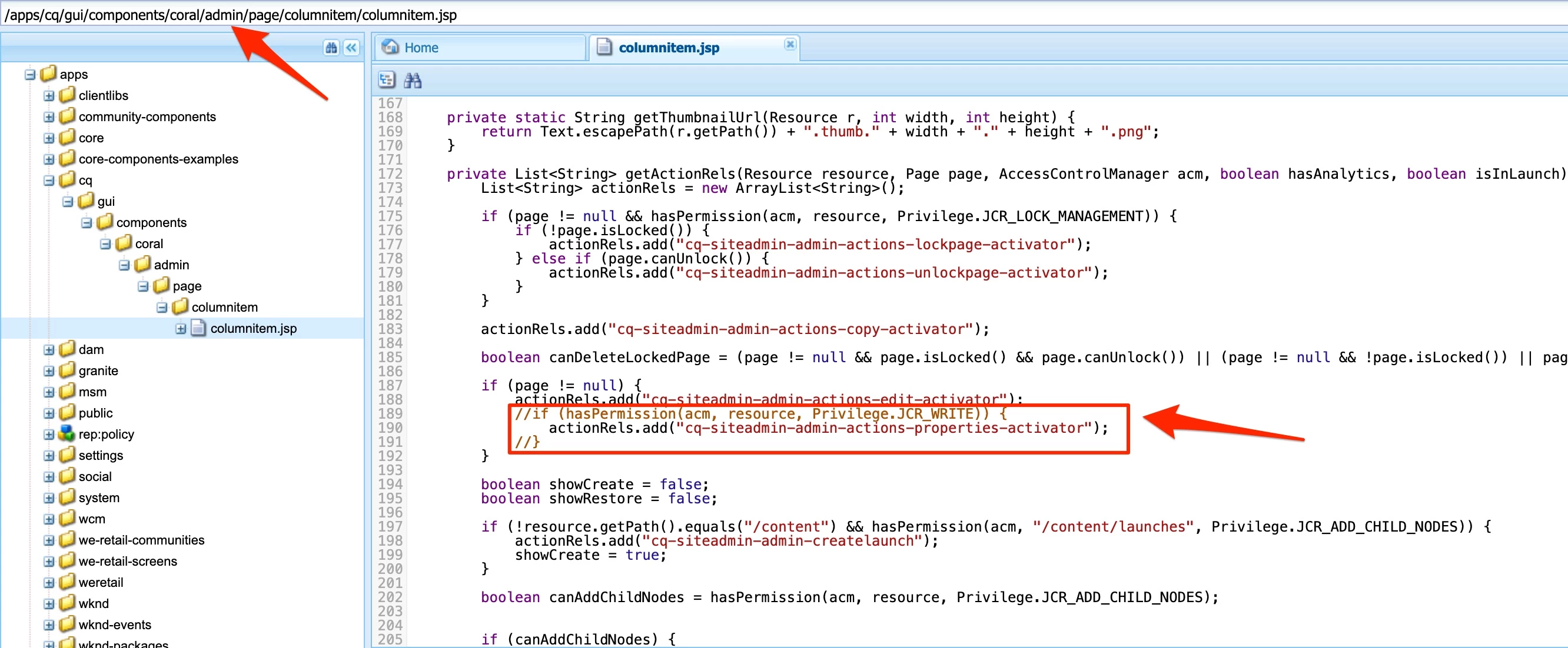

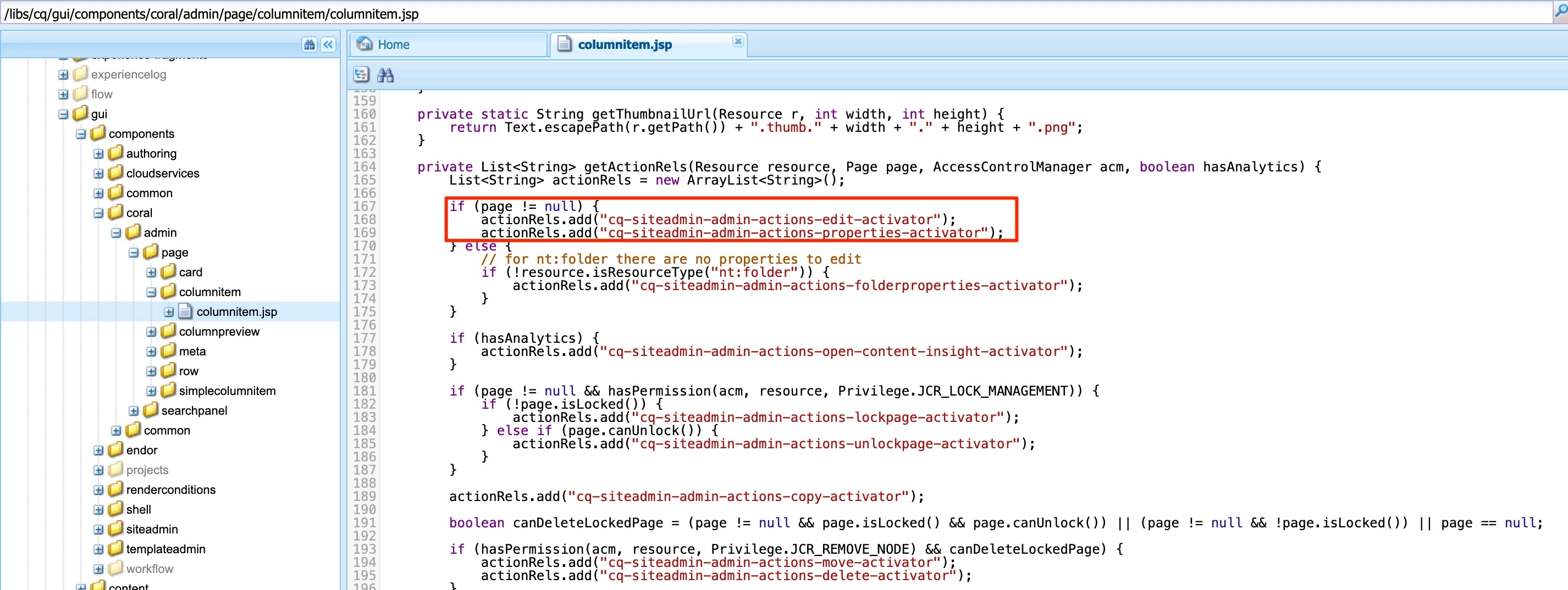

This is how it looks on AEM 6.5 (without any service pack)
As you can see the only condition is to check if page is not null. So this is why Page Properties can be seen by users with Read only permissions on AEM 6.5.0 and some other versions.
This is how it looks on AEM 6.5.10 (SP10)
Additional condition has been added, which cause the result you can see. The additional condition checks if user has write privileges.

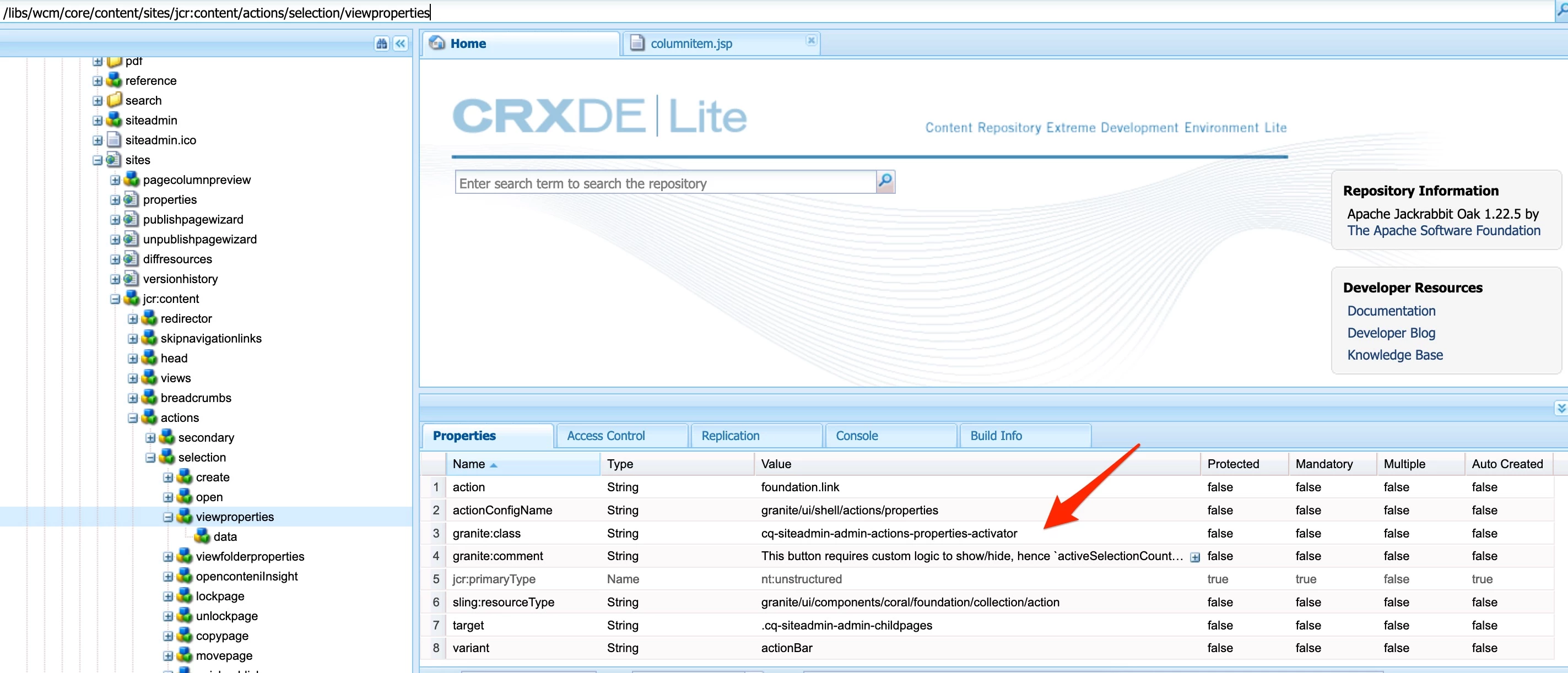

You can simply run search on crx/de to find other potential locations that use cq-siteadmin-admin-actions-properties-activator.
