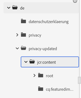

Hi @h_kataria, after looking into it a bit more I did notice something when looking at the publish instance.
while the actual alias is within this page here:
So it does seem that this is due to the duplicate alias being used
After checking out more of the broken alias links, I'm noticing the duplicate alias issue is not found for these specific links. These pages have only the specific alias but after unpublishing / republishing, it seems to be working. Wondering if there is a deeper cause that could possibly affect this codewise.
