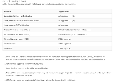

@chandra_s_gupta The AEM server is Java-based and runs on most operating systems that support that platform (see Technical Requirements). All client interaction with AEM is done through a web browser. Please check the below screenshot for the supported OS.
Referenceshttps://experienceleague.adobe.com/docs/experience-manager-65/deploying/introduction/technical-requi...
https://experienceleague.adobe.com/docs/experience-manager-65/deploying/deploying/deploy.html?lang=e...

@chandra_s_gupta It's based on the choice of the business, AEM on-prem supports both windows and Linux. Depending on your infra requirements and the other middleware that are supported in your org you can make a choice with what to go for. The OS. Do keep in mind that the support varies if you are using forms or migrating from older version. Do validate the "Support Level" column.
