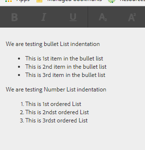

                    Am using OOTB text component, while using bullet list i noticed that even though if i give the indentation, bullet list is aligning towards left but, indentation looks good in RTE once i save indentation will be lost, weird thing is indentation works perfect for numbered list.
This is how it looks in the RTE

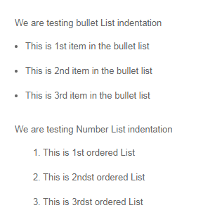

This is how it looks when i do viewaspublish
Am i missing anything here?

I have seen similar product issue with 6.3 List.
Try to install latest SP for 6.3 else I would suggest you to raise a issue on daycare to product team for fix.
Check if your application custom CSS impacting the alignment on the page by inspecting the list.
ANother Suggestion is try the COre Text Component.
