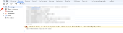

Could you check if "info" is unselected by any chance for log level in your developer console. It should be selected.
This section for Default Levels is greyed out for me.
-Anish

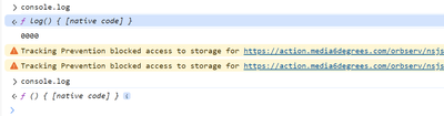

Then while debugging, when debugger is paused at console.log("99") statement, before executing that, go to your console and just type in console.log. It should show something like,
If you see something else, then probably some modification might be happening in the time when your page starts to load and before your DOM gets ready. In that case you can just double click on it to check where the culprit is.
Hope this helps.
Debugging the way you have recommended. This is the result:
Looks like the console log that outputs have "f log() {{native code}}" in there however the one that doesn't have output have "f () {{native code}}" in there. Looks like somehow the log is not executed.
In debug mode:
log that prints output:
log that doesn't print output:

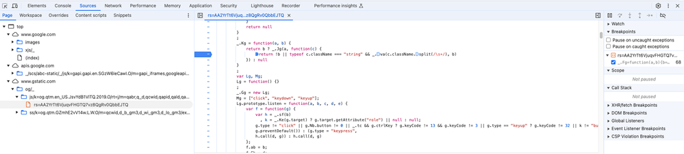

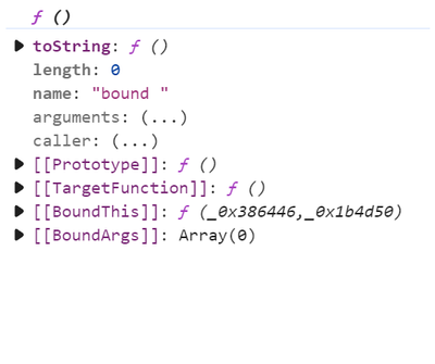

It seems some function binding is taking place to your console.log by the time your DOM gets ready. You should be able to double click your f () {{native code}} during debugging and it should ideally take you to the file where new function is defined and can check within your team to the person responsible for it to understand it better.
Can you provide screenshot on what you are referring to? I tried double clicking on f() {{native code}} and it doesn't take anywhere.
