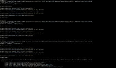

The issue was in running server, jpa log file wasn't rotating and it took around 650 GB and aem repository get corrupted. The configuration is not upgraded its
AEM 6.4, Java 8 and oak-run-1.8.2 on Premise. I have seen some previous question which were giving good revision by running
java -Xmx6000m -jar oak-run-*.jar check crx-quickstart/repository/segmentstore/
but in my case I get the output which is added in screenshot. It is like a deadlock for me I have tried a lot of things but nothing seems working Can some one guide me to get last good revision so that I can run recover or compact activity

Your AEM instance is failing because the repository has become corrupted (likely from the huge unrotated JPA log), so the Oak segment store cannot find a valid checkpoint to start from. That’s why oak-run check reports nothing usable and AEM throws the “AuthenticationSupport service missing” 503 error. In this state, you can’t “fix” the current repository — instead you need to restore from the last known good backup (filesystem or datastore backup). If no backup exists, the only option is to attempt an oak-run offline compaction (oak-run compact) or a checkpoints rm-unreferenced cleanup to try to free it, but recovery is not guaranteed. In practice, the safe path is restoring a valid backup; otherwise, data loss is very likely.

I have created new publish instance. nothing worked in my case.
Hi @NituDh,
Looks like your AEM could not bootstrap its repository because the Oak Segment Store is corrupted. The oak-run check output confirms this: multiple SegmentNotFoundException and no valid checkpoints found, which means the repository state cannot be reconstructed normally.
