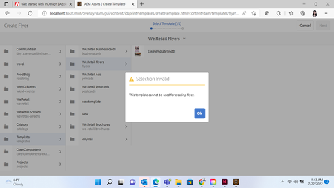

not able to create brochure in AEM asset templates
I created one template in InDesign with extension indd. Tried to create brochure by uploading the created indd template getting this error.
How can we resolve this?
Hi @dnyaneshwari_mahalle,
The root cause and solution for this issue is exactly the same like the one described under following topic:
In general, to make it work you will need connection/integration between your AEM instance and INDD server.
Once this is done, as a next step you will need to re-upload INDD files once again or run DAM Update Asset workflow against existing INDD files. This step is needed to have correctly processed INDD files on AEM level.
Some additional guideline how to integrate INDD with AEM you can find under:
getting same issue for other options
